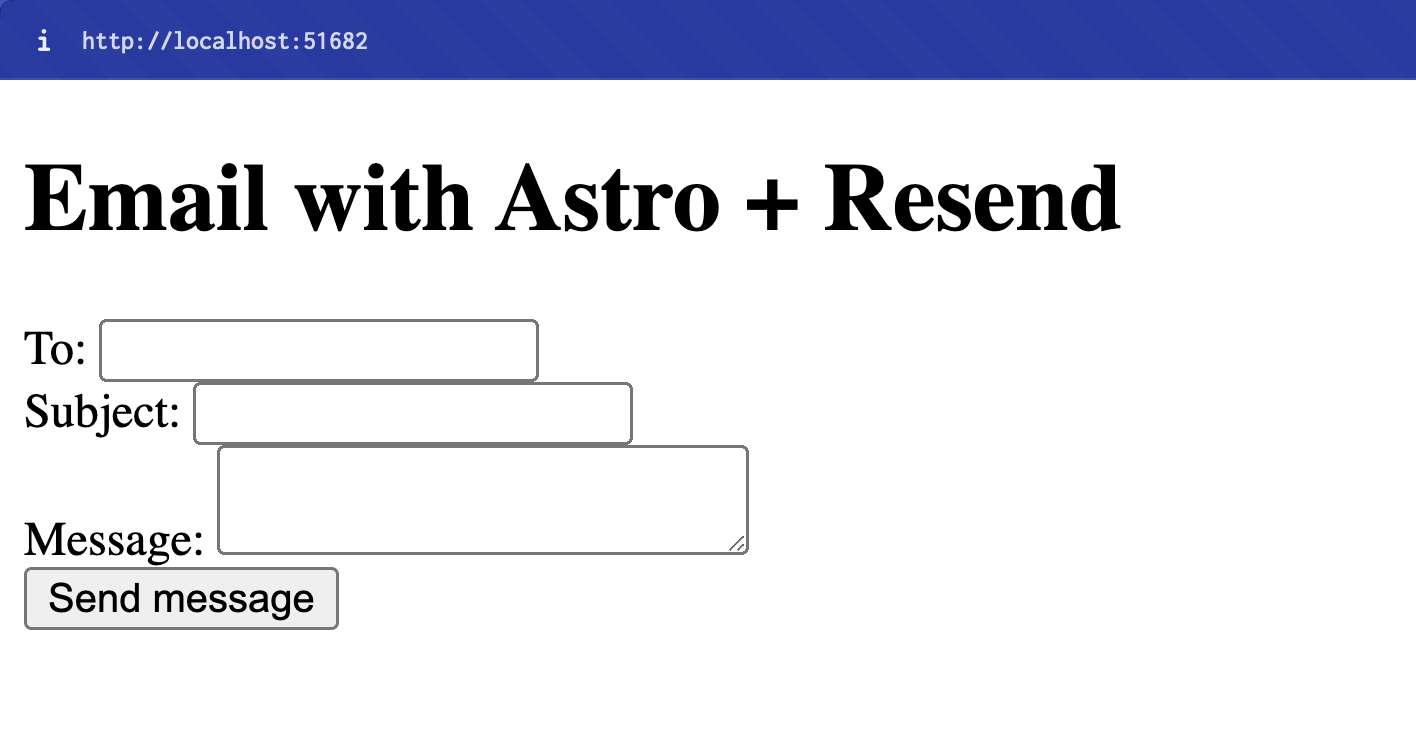

Here’s what the unstyled form should look like:
Unstyled email form on the main index page

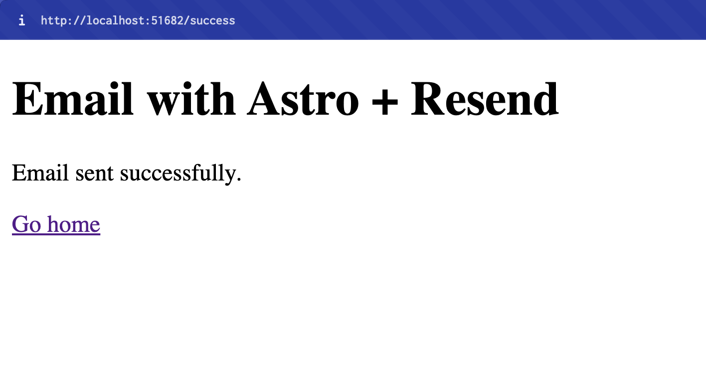

Test the email service
Now you have the basics and if you fill out the form, you should see the email sent successfully.
Email will actually be sent!
It’s easy to get into the habit that what we do locally doesn’t trigger something real. But in this case, the email will actually be delivered by Resend.
For that reason, be sure to send to an email address where you can access the inbox to see the email arrive.
Success page view after successfully sending an email

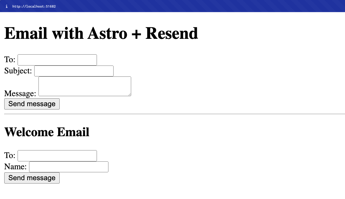

Reload your home page and you should see two forms: one for sending a custom email and one for sending a welcome email.
Two forms for different email template types

Test the templates locally
Now you have what you need to test it. Fill out the form for the welcome email and you should see the content from the template delivered to inbox of the recipient entered in the form.
Success!
If you’ve made it this far, you have the beginnings of what can become a robust email system to serve apps at scale.
